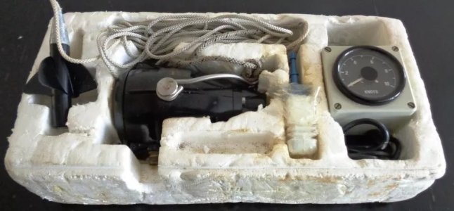

The Electradepth was fitted to my boat (not working) so I modified a NASA log to fit the redundant skin fitting. The log could then be retracted and the housing then rotated sealing it off from the water. Never needed to antifoul and could be removed without a drop of water entering the boat. It was a large chunk of bronze though requiring a big hole for fitting! They also did a log version.

captainboo, that looks rather like what I was thinking of, only better. Impressive. I imagine these might have been rather expensive originally, which may be why the flap became more prevalent as the "good enough" option.
