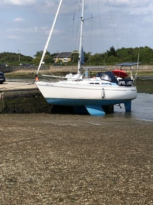

I commented on the other thread that I couldn't notice the difference between our bilge keel yacht and a week spent on a fin keeled charter yacht.
Memsahib and I both like exploring and creek crawling, so bilge keels for us.
Keyhaven quay, a lovely spot with a very friendly YC we regularly stop at.
For Pete, if your regular cruising destination is the Scottish Western Isles, then I could see bilge keels being useful for many of the small drying harbours and beaches up there. Moody made a series of 33, 34, 35 and 36ft yachts over the years with bilge keels in a number of different styles from stern cockpit to centre cockpit and pilot house etc.

Woke up in middle of night wondering why we were dead still. Tide had gone out leaving us sat on our bilge keels hard aground with the mooring ropes bar taught. Managed to untie and reset ourselves no problem.
We'd never thought to check the depth - shallows at shore end of pontoon (landsmen's expectation to be coddled with warning notices everywhere).
Not sure what would have happened with a fin...

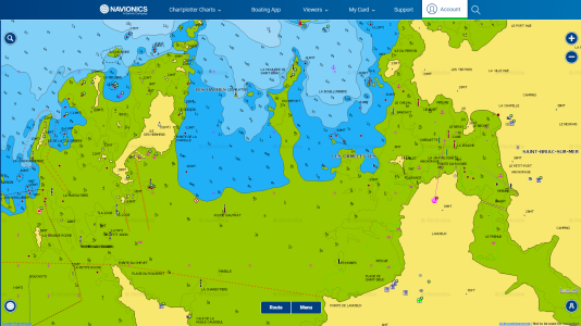

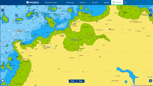

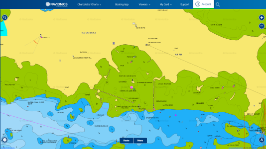

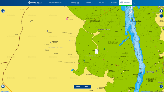

Sounds great. You could spend a summer in France and spend very little on moorings, some of these places you could sit out a hurricane in safety and not spend a penny except on wine. Too late for me but I sometimes have a day dream about it, so to answer the question, right now I might well go for a twin keeler
Surprising that twin keels are not more popular in Northern France.
That's the plan, just need to retire first. Not sure were to go first, Scottish Western Isles, Baltic or Brittany.
