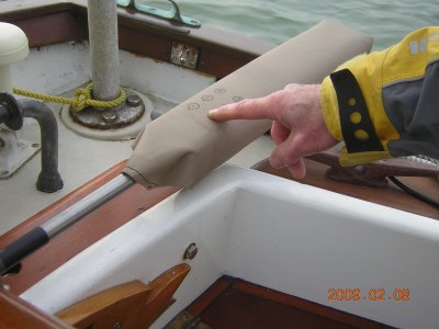

Agree with the others that the Raymarine tillerpilot is very durable, providing you make a waterproof jacket for it.
Www.solocoastalsailing.co.uk
Just checked my records. New Raymarine ST2000+ fitted in 2005. Failed due to water ingress after 18 months. Raymarine confirmed water ingress and repaired it, knocking 30% off the bill due to the short life! I then made the cover for it and it is still working.

Bluster and nit-pick away to your heart's content, as is your wont, but you seem to be in a minority of one with your bizarre theory that a cover "increases the risk of moisture damage", and that's having admitted admitted that you have had water ingress that stopped one of your uncovered devices working. Maybe that was a special kind of Gotland rain that doesn't come under the category of 'moisture'. :ROFLMAO:
Anyway, I'll leave it at that. In my opinion and experience a cover prevents damage from water ingress; others may disagree. Wait for incoming...

The debate about covers causing moisture problems relates to entrapped moisture (ie in a partly or completely sealed cover) being drawn in as the device cools down. If the cover allows plenty of air flow, this is not a problem.
