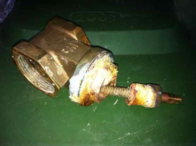

But they do, that's what we're trying to tell you. Lots of examples.
And yes, the number is quite low, but that doesn't mean it's not worth thinking about or moving to a very clearly better option.
The proper clips do rust. The very nature of the installation lends itself to stainless corrosion.
The makers are now selling at volume into both aftermarket and OEM. No idea why you think they're niche, it's already widely accepted and being fitted on many new production boats (not the cheap ones yet). Every through hull conversation on these forums and Facebook groups mention TruDesign and from what I can see they are usually chosen as the best option.
Indeed they most certainly do ...
Tranona
10 Nov 2007
43,047
That is a gate valve and a good illustration of why it is not recommended and why it is suggested that the OP replaces his with a DZR or bronze ball valve. The failure is nothing to do with the material of the body, but the construction and materials used in the operating mechanism. That is common in gate valves with other materials used for the body.

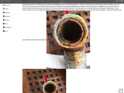

I didn’t feel a need to contribute to this thread any further - my original question was answered and I received some helpful advice but then I saw this on the Hallberg Rassy owners group site just now. Thought it might be of interest…4D9D2B00-7A3F-4C2D-9E69-9002DC36DC59.png
