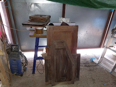

First I had to dismantle the affected doors like this door and clean up the joints and then clean the joints with acetone and then use a modern glue to glue and fix the joint back together.
Then clamp the joint together with sash clamps until the glue cures off and the clean off the excess glue and with a quick rubbing down with some sandpaper , then start to varnish the door like the rest of the doors that have already been started to be varnished.
Some of the doors are having to undergo some more major work in that there are more than one part needing to be replaced, As in the case of this door in the photo below
This door is just in need of a single part of the frame of the door. Like the other doors I am dismantling the doors and cleaning the doors and then gluing them back together with modern glue and then varnishing the doors as they are being rebuild

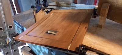

These are the doors from the galley unit which were the doors from the locker above the area where the cooker was originally fitted and above the worktop. These have had their first coat of thinned varnish and will be getting a lot more over the coming weeks.
The two halves of hatch cover over the main cabin to cockpit door. In a previous blog you can see that the main cabin door is already undergoing its varnishing treatment.
The main cabin door hatch covers and the galley doors getting more coats of varnish as we build up the layers of varnish.

The door below is going to need a bit of repair work to the split in the centre panel

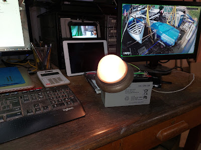

Salvaging an old roof light from Chance when she was first built in1948
This cabin roof light came from Chance, it is from a time when Chance first had electric lights fitted to her early in her long life. The bulb just needed its contacts cleaned up and a pair of short wires fitted to the blub socket and then contacted to a testing battery. Eureka , it works not bad for an early light bulb and light. So when it comes time to refit the lights in the boat this will be going back in the boat
There are also a number of other lights we have been able to salvage from Chance has we dismantled the interior of the boat.Many of the other lights are still being manufactured by Davey & Co. Some of the lights need a new glass which is readily available. from Davey & Co.
So all being well we will able to refit period lighting to the interior of Chance when it comes to that stage of the restoration. The only change to modern times will be a change in wiring the lights with modern wiring and possibly new bulbs to give better lighting below decks. Also the wiring runs will be hidden as much as possible.

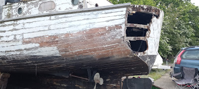

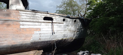

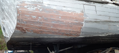

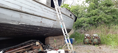

The big difference a few days make after removing the old paint off the hull to see the extension of the amount of planking needing to be replaced
Before I started on the hull
Doing a test patch with my large sander with P40 girt sandpaper, it cut through the old paint well to leave a good surface below which will need a little light fairing once the new planks are fitted
Doing a bit of the port side to get the hang of the speed and the amount of changing discs
Then I made a start on the starboard side, to expose the fixings so that the to drill out the old putty out of the nail holes to stop any breaking out of the planks as the nails are punched out of the ribs that are getting replaced in this area of the hull.
Halfway down the starboard side only another 20ft to go on the starboard side
Along way to go, not finding too much more than, i did not know was rotten, however I was able to find the positions of the main mast chain plates under the paintwork once it was removed.
2/3 of the way there and the end of the first day of sanding
The port side well underway on the second day when I had to stop because I was exhausted from sanding and my arms felt like lead.

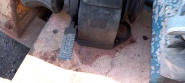

The first job with the windlass will be to give it a good cleaning down and check all the moving parts for wear and if any is find get the parts remade to fit the windlass
On the manufacturers plate it is a AFCO Marine Windlass
It is not likely that the company still is in existence, however, their windlass is still in god condition after all these years.
Once the decks are relaid it will once more be put back in its original position on the foredeck and will be put back into commission and used again
