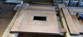

Rebuilding the small galley cupboard doors, first taking them apart cleaning the tenons and gluing them together with modern glue.
Using these clamps in the reverse way, which you can do with this type of clamp with a little pressure the joints come apart
A little at a time the tenons come apart
Then off completely and now ready for a clean up of the tenons
These tenons had small wedges to tighten up the joints which are left in place so they can be used again when a small amount of glue is placed on the wedge before the tenons are re-fitted
