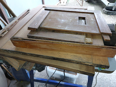

Some of the other small doors have not faired as well and will need some replacement parts made for them, it some cases more than one piece, others just need just one side of the door.
Other small doors just needed gluing back together as the old glue as given up and the small wedges in the tenons are not enough to hold them together any longer.
A small amount of cleaning up the joints and a small amount of modern glue and gentle cramping together and then a quick sanding down when the glue is cured and then they can be put with the other doors to be varnished
However, these pair of doors are not so good as they are either broken or rotten and in the case of these two doors they are both rotten and broken, so these two doors will have to be completely rebuild

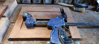

Rebuilding the small galley cupboard doors, first taking them apart cleaning the tenons and gluing them together with modern glue.
Using these clamps in the reverse way, which you can do with this type of clamp with a little pressure the joints come apart
A little at a time the tenons come apart
Then off completely and now ready for a clean up of the tenons
These tenons had small wedges to tighten up the joints which are left in place so they can be used again when a small amount of glue is placed on the wedge before the tenons are re-fitted

This week I will be starting to rebuild the cupboard doors that were rotten in some parts, so although they are going to be a slightly different colour mahogany with a little bit of staining to get the colour more to the rest of the doors, When doing any restoration look will try to match as much as possible.
A couple of the smaller doors are in need of new parts to be made to replace broken or rotten parts. Others just need taking apart and modern glue used to fix the joints.
This is the first of the small doors getting glued together after the joints were cleaned and modern glue put on the mortise and tenon joints before being sash clamped together for the glue to cure and then sanded down
The first two doors on the work bench clamped and left for the glue to cure and then they will be given their light sanding and then got ready to go with the others to be varnished.
