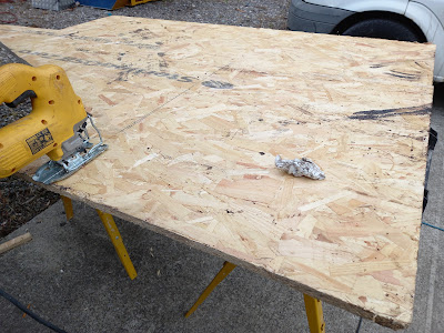

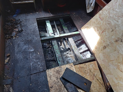

Making temporary floorboards so that the old floorboards can be removed and cleaned and repainted before putting them back later
The first of the temporary floorboards in place more to come as the months go on
Some of the equipment getting removed so that we can access to the hull to make repairs to the hull planking

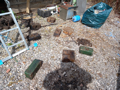

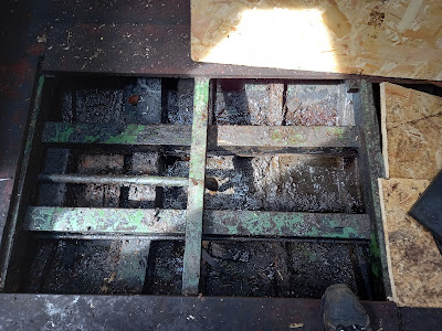

Then to removing the ballast out of the bilges for the first time in over 70 years and they were in a hell of a state, covered in dirt and oil and god knows what else
About a 1/3 of the ballast out and more to come as we were able to remove floorboard that covered them
There has been a fair few of these large buckets full of rubbish and other shit coming out of the boats interior and there are going to be more to come as the months move on

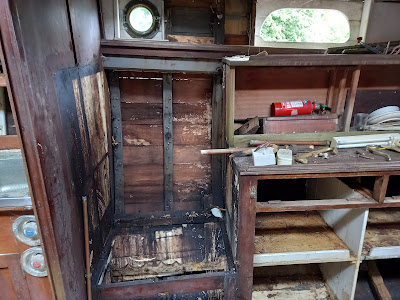

So the first job today was the removal of the cupboard top to expose the framework underneath and find out the condition of the framework. Some was in reasonable conidtion and other pieces were well rotten and turned to dust.
Once the top was off and the divider in the cupboard was removed the back paneling which covered up the ribs was removed to expose the planking
A bit of a mess was the answer about what I found, Badly renewed ribs which did not go the full length to the deck and where they what fitted in was not correct as they did not sister up the ribs past each other far enough
