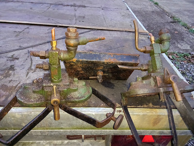

The twin fuel filters which were fitted to the forward engine bay bulkhead and one of the the drip trays
The top of the fuel filters showing the fitting going into and out of the filter bodies

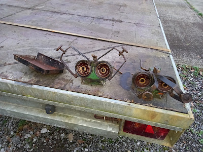

another yet another fuel filter

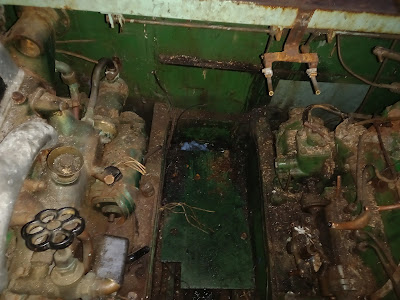

The port engine ready to come out with the use of a crane in the morning
hopefully the last photo of the engines in the engine bay and hopefully the next photo will show a empty space.

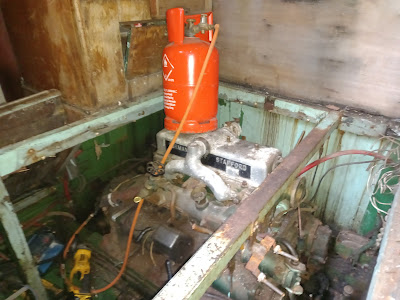

This is the engine bay before we started

This is the space they leave behind, there is enough room to put a modern 35 hp diesel engine and a genset ahead of the engine and have enough room to work round each engine easily.
On the port side there will be enogugh room to put a water heater and diesel hot air heater as well as room for a good sized battery bank for all the services on the boat.
