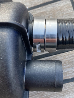

I see no reason not to double-clip where the horsetail is long enough to comfortably do so, but in the pic below it isn’t possible without the second clip overlapping the barb on the end of the tail (both tails are the same length). My feeling is that it’s better not to double clip in this scenario - any argunents? I’ve been unable to source narrower clips.
I have seen no evidence that double clipping is more reliable than good single clipping. In your case I would use one good quality clip.
Sand the barb down to the same diameter as the rest of the spigot, cut the pipe at 90 degrees, and push it right up to the body of the (?) pump. Don't forget to put the clips on so that they face opposite directions (i.e. you have to use a screwdriver in opposite directions.)

Double clipping is one mitigation of a hazard. There are other mitigations @Plum states one, the use of good quality clips.
Speak to your insurance company and get their opinion in writing about what you are proposing. Should you move away from 'best practice' they may not pay out on any claim you may have.

You do not say what the container & pipe actually is. If it is an exhaust pipe, one can purchase a proper exhause pipe fitting ( Not a "U" bolt type but one with a proper complete circle & tension bolt) This gives a much stronger clamping force than a jubilee clip. Even the best jubilee clips will strip their thread if taken to the limit. Then add vibration & temperature variation & hey presto- A slipping clip.
There are situations on a boat, where even if the complete fitting came free, pipe & all, the vessel would still not sink. But that is not always the case. One needs to use some common sense when considering what action to take.
I am fortunate that I have a hydraulic supplier near me in South Woodham Ferrers, Essex, & they can supply such fittings (& pipes)of the exact diameter rather than the "nearest" size etc.
I double clip where it's possible, but in the OP's example I would have more faith in a single correctly positioned clip (and a spare in the toolbox) than in two sub-optimally placed ones - I'd also liberally grease the screwy bit, I've seen more clips fail from crevice corrosion within the mechanism than from anything else.
