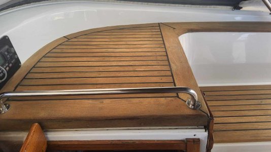

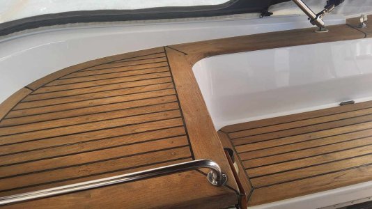

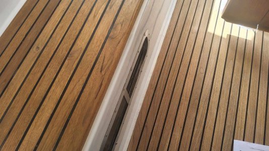

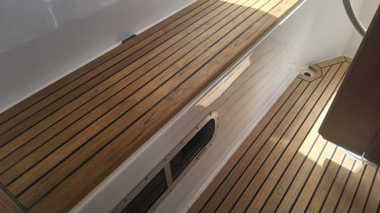

Semco natural just being applied to teak. We have 44 year old teak on the high level part of the cockpit. 2016 year teak on the floor and seats. Without the sealer, the teak get dirty quickly. The sealer is super oily so water runs off. The teak soon goes grey without the sealer. Grey isn't a problem apart from it attracts dirt. It's easier to clean the sealed teak.
In the photos, the floor has just been cleaned. No Semco applied yet. You can see that the colour of the Semco treated teak is almost the same as the just cleaned teak
