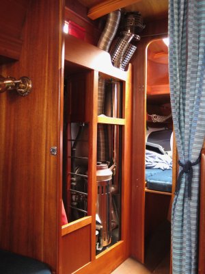

I don't know about Taylors, but for instance Refleks diesel heaters can be specified with a combustion air intake, which can be used to create a "balanced flue". This can overcome the down draft problem to a large extent, I believe.
My diesel cabin heater is very similar to the Refleks. Air intake is on the coach roof beside the exhaust pipe. I have not had any down draft problems with this set up (although I have not really used it while sailing in heavy weather, only moderate conditions).
