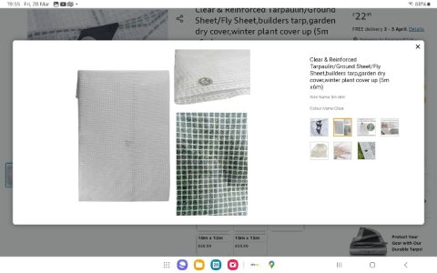

Clear mesh tarp as in pic below. Everything needs to be smooth where it contacts, preferably with carpet else it slowly wears through.
Ropes through eyes -eyes soon tear out. Wrap tennis ball in edge of tarp then wrap rope around. That lasts very well but still eventually tears tarp.
My best solution was to put roofing batton screwed together either side of tarp edge with rope clamped between at each end for tying down. That lasted well.
I also filled 4pt plastic milk bottles with gravel and hung them on tarp as weights. Absorbed violent gusts
I did 7 months and it would have certainly lasted a lot longer.
My mast was laying on the boat and used poly water pipe and cable ties to form curves for tarp to sit on
