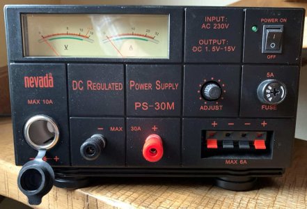

59 quid for a regulated 240 - 12v PSU ?????? and only 5A ????
I have a bank of regulated 240 - 12v 10A PSU's for my Lithium chargers ... I can buy two for the price of that chandlers version .. and the 12v is clean.
Fair point. Didn’t check the amps on that to be fair. Mine is a higher rating for sure. I got mine with the weaco fridge years ago.
No doubt there are cheaper. I can only testify to the quality of the one I have similar

Your device and the OPs requirement for a noise free DC supply are likely not mutually compatible. An item made to power a fridge via a cigarette lighter socket may not have the smoothing and filters necessary for a sensitive computer/weatherfax receiver project.

True - but its not like 10 .. 20yrs ago ... today there are very 'smooth' regulated PSU's that do the job OP wants for budget money ..
If not wanting to check out such - then as I and others have suggested ... SLA battery ... easy peasy.

Not relevant. It doesn’t make a noise at all 😂.
But seriously though, I was having a look for the one I have. Can find similar but not exact. It’s rectified and designed for compressor cooling systems and items of a sensitive nature, requiring a clean wave.
But no doubt…everyone else knows better than the next guy on here !
