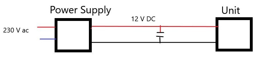

Alex_Blackwood
19 May 2003
1,853
Fareham
Just to keep it simple. Remember polarity is important with electrolytic capacitors. Capacitor can go anywhere in the DC line, preferably as close as possible to the unit being supplied.
