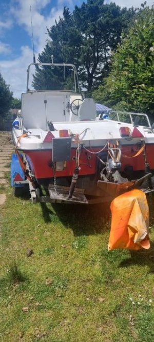

Can anyone tell me the name of this stern drive and what they are like, reliable or not etc, there as been a retrieve handle added to lift and lower the leg
As its on a boat I am thinking of buying just waiting for seller to send me closer photo`s of stern drive, he does not know make and no makings on it, will post as soon as I receive them
From the pic it looks like an old enfield 130 with a homemade steering arm, very basic and bits are still available, ok for lower power drivetrains and home fixable.
The fins/foils are add ons, probably lazilas.
I'm with Snowy, Enfield. Simple and reliable. Should have an internal gear to allow the leg to be wound up sideways. If not you may be able to get the parts to refit. Not an essential though!
