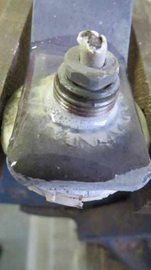

This photograph shows an aluminium masthead antenna bracket with an antenna base firmly 'welded' to it by typical carbonate seawater deposits. It can be seen that I have removed the nut and locking washer but the fitting was immovable without the risk of destruction. I dripped a small volume of hydrochloric acid onto the white deposit, it fizzed nicely and within a minute the base could be pushed out.
Hydrochloric attacks pure aluminium but most alloys with additions of other metals are fairly resistant, Attack is not severe or rapid and prompt washing in water will mostly prevent any visible deterioration.
