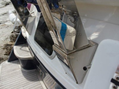

Just bought a pair of 500kg Davits from another boat in our marina for €650, they have never been used in anger. IMG_1306.jpeg
A bit of overkill for the little dinghy we have, wish the original davits had been kept on the boat!
Hunter on the Oosterschelde around the middle 1990s
Here you can see the mounting plates on the transom.

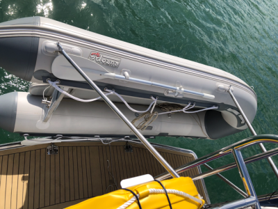

I have snaps on our boat which are set up so that we can still access the swim platform down the ladder from the raised aft deck and the folding ladder that drops down into the water. Also important for us is retaining the ability to fully open the hatch from the aft cabin to the swim platform, as this acts as one of our emergency escape routes.
Having to de mount and mount the 5hp outboard onto the dinghy is a bit of a pain, but this lives on a bracket on the swim platform side strut when not on the dinghy, so at least I don’t have to lift it up onto the aft deck!

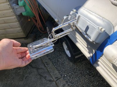

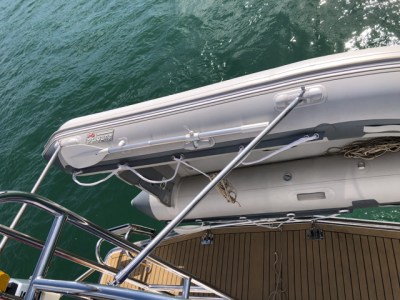

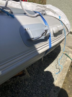

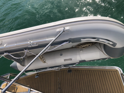

Yes, inflatable air deck 3.2m. I think it weighs around 50kg
The weight of the tender is sitting on the snap davits, with the two stays then holding it off the transom so that we have clear access to the swim platform. We’re on a swinging mooring from April to the end of October, so this arrangement gets used a lot. The usual sequence when we arrive at the boat is to climb out of the dinghy onto the swim platform, clip the davits on, de mount the outboard (with the davits clipped on, the dinghy is really stable in the water to assist with this), then using a rope attached to the port side (furthest from the stern) of the dinghy, haul it up into the vertical position and attach the stays. It can also rest and be attached against the transom ladder but this does restrict our emergency egress through the hatch should we need it.
The snap davits can be detached from the swim platform when required, leaving just a stainless low profile “socket” in place. I made the stays myself and they attach to the guardrail stanchion and can be removed when not in use.
