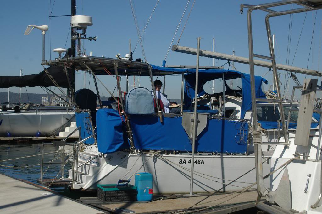

Mine also supports my cockpit cover and various safety equipment. Mine is made of 50mm o/d 316 stainless steel tube main tube ha 4 bends and the aft leg welded to the for shaped legs/ solar panel support for 4 solar panels.
After launching the boat and all the safety equipment and cockpit cover/solar panels.

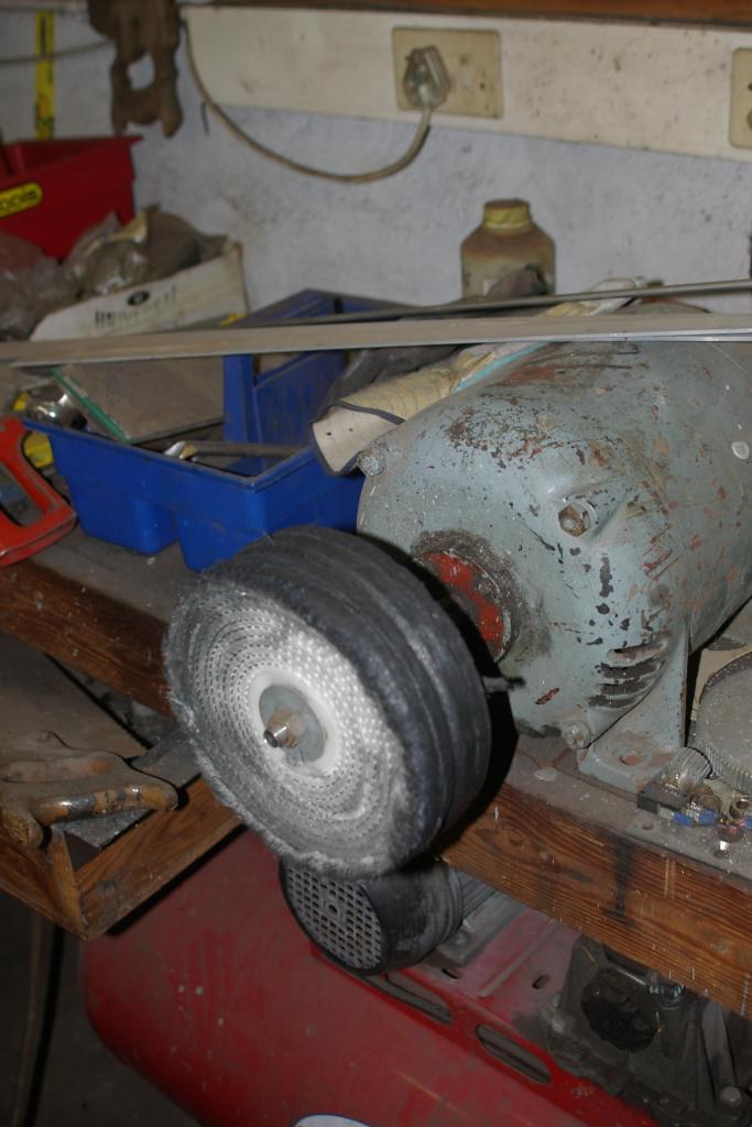

On flat bar I start with an angle grinder with 120 grit sanding pad then 120 grit flap wheel to 240 then 320 grit then polishing mop either on angle grinders as below or bench polisher made for a second motor.
Polishing equipment as below
Stainless can be electro polished but its no where as good as hand polishing and why hand polishing cost so much is its a horrible and dirty job so I will not do it for anyone else and if I can get a local to do it for me I will labourer.

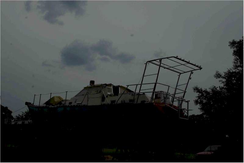

I mocked my gantry up in 19mm x 19mm timber and gaffer tape so it could be measured, including angles of bends. Had a local guy bend the two 40mm tubes for me then cut the rest myself. It was stick welded up on the ground in the yard, welds not very pretty as wind was blowing shield gas away but they're strong enough. Have never got around to pickling the welds (nasty stuff) which would improve appearance. Since photo taken Aerogen binned and panels increased.
nice job,,, btw,, a jar of pickling paste costs about 25 £ and will last you for ever ,, not really too nasty if you are carefull with it and wash it off thoroughly . i use that white p
