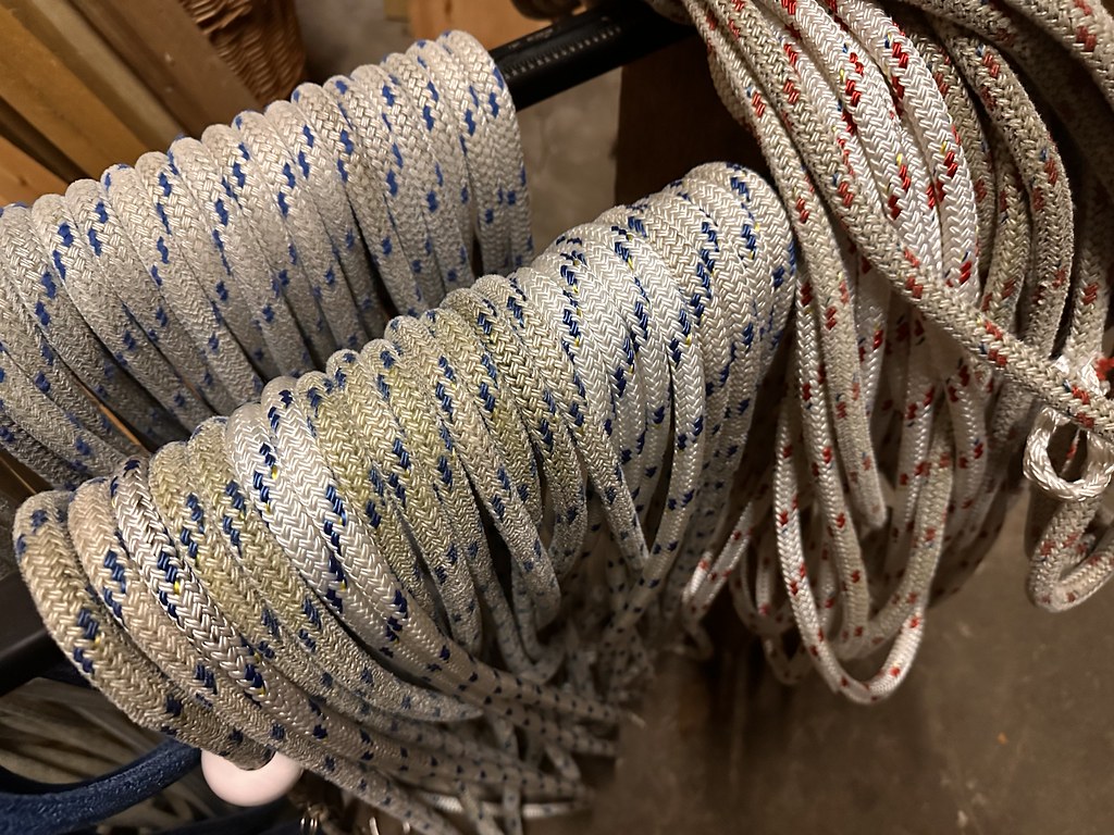

Washed all mine last year and tried a few things: -
1. Renovo Marine Rope Cleaner worked okay, soaked for a few days then rinsed in the washing machine on rinse only cycle.
2. Washed in the washing machine with biological soap powder on quick wash cycle.
3. Renovo then followed by wash in the machine with biological soap powder on quick wash cycle.
There was no real difference between the three options, including leaving one of the lines for a prolonged 4 day soak in Renovo.

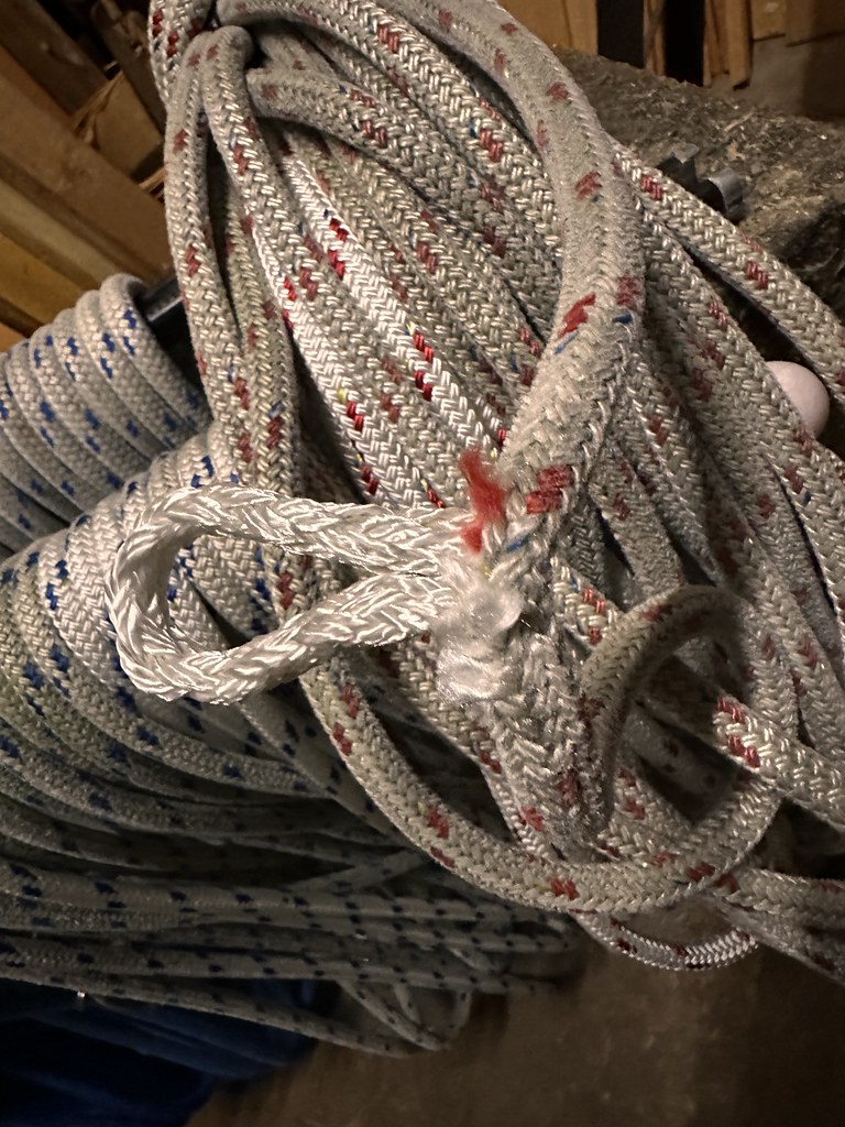

Key point, don't put a line in the machine with a damaged sheath as the washing machine will pull the inner line out.
My advise is just use the washing machine with soap powder.
Typical Dirt Before Washing
After Washing (Any Method)
Inner Core Pulled Out in Washing Machine
... Newer ropes in general are vulnerable unless bagged.

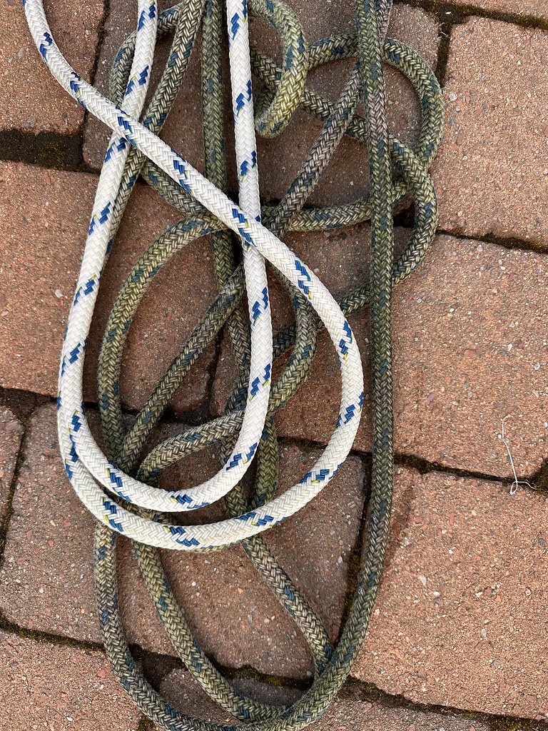

Soaking a mainsheet in WYX “laundry cleanser disinfectant” right now, after trampling underfoot in the shower and an overnight soak in the shower water. Bit of a risk since I dont know whats in this stuff, which isnt something I would buy (wimmen, yknow?) but it says its bleach free.
The rope was very green and crusty after 5 years or so abandoned aloft, and may be too UV damaged (even in Scotland) to be savable anyway
Im impressed that so much growth can be sustained just by airbourne dust.
Come to think ont, I wonder if it might offer some UV protection, which it would seem it ought to compared to clean rope
