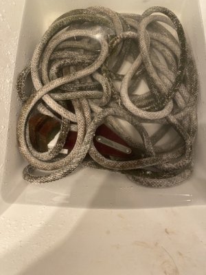

Those sheets came up not bad. A thicker main sheet similary solid green and crusty soaked with Tide liquid 24 hrs and then trampled in the shower (awkward since it still had a block attached) seemed to start shedding fibres, suggesting its probably had it.
It seems to have been originally white, giving it an unfortunate current resemblance to weathered dog shite.

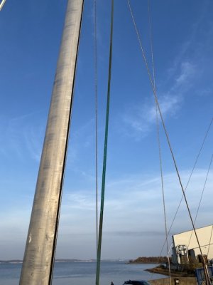

… Depending on cost I favor replaceing with GREEN ROPE.
Why doesnt everyone?View attachment 208078
I don’t particularly like green on a boat, so not likely to want a green sheet or halyards. There is a sort of colour code on my boat, which does differentiate lines. That’s two reason in my case, in answer to your question. A third reason is that I am quite conservative and green would be to stray too far from a self imposed status quo. Apparently anything with a green hue does not promote good luck. Sailing superstitions: 13 things never to do at sea! - YBW
Because it is very quick and simple to keep ropes clean and free from green marks using the likes of Patio Magic, and I prefer being able to see if ropes have got dirty so can clean.
If they got as dirty as these ropes (which have been exposed for about 5 years) I think youd be able to tell with eyes shut. Id think green rope is likely to get jess algae in the core, since there ought to be less photosynthetic radiation available. More importantly, perhaps, Id suspect UV damage will vary with colour, though I dunno whats likely to be best. Black? Probably not white anyway.
But what of the famed Luck Of The Irish?

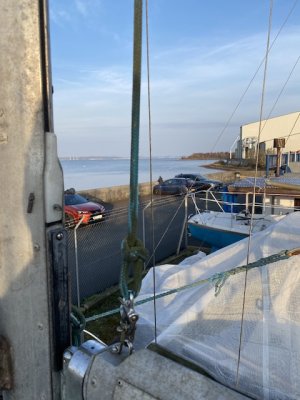

Green halyard (or is it blue? IIRC it looks green IRL but I'll check tomorrow) got left iup when I was here last year )cant remember why) and has been left up this year in case48386660-D678-4D9F-BE7A-2D458D98D9D7.jpeg its useful for dropping the mast, so its had about 1.5 years more exposure than the crusty cordage Im washing at the moment. It has some algal staining, but MUCH less.
Could be coincidence, of course.

Still a bit dog turdoid, but looks better after being between the clothes posts for a breezy 24 hours, with only a little of its algal "sheath" still intact near the block, which probably protected it from the trampling and sink plunger.
So it seems you dont need to use a washing machine to get very dirty ropes to a usable condition.
The fibre shedding seems to have been due to damage from the cam cleats built in to the mainsheet block. I'll have to see if I can avoid using these in the future, if there is a future.
