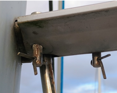

These are far too long, correct length should be used and should be folded back round the clevis pin. That is to my mind a sloppy job 😵‍💫 ;)
Whoever put these in needs shooting.

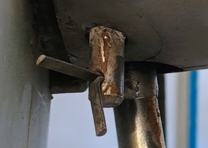

You might like to take a look at this.
At this stage I can still blame the previous owners, but now I've had enough time pay it some attention it looks like I'll be sourcing some shorter clevis pins and securing them shorter split pins, ends filled smooth and dabbed with transparent silicone.
The picture seems to show a stay wire with an eye end attached by clevis pin to one side of a hole through spreader base. That to my mind is really poor design as load should be on both sides of the clevis pin. The arrangement as is, will put a cocking load on the pin and hole in spreader base.
The better fix would be 2 pates on clevis pin from spreader base down to another clevis pin to stay end fitting. I assume you can not get a fork end stay fitting that will be open enough to reach around the spreader base. Unfortunately this fix will mean shortening the stay wire. ol'will
If you load the picture into another tab ... expand it - you will see that the split pin is only locking the spreader in place .. you can see the circular head of the split pin with the stay behind it ...
Not exactly load bearing .. but also not exactly 'pretty' ! A split ring would be IMHO better looking ... or as many boats have - a suitable nut and bolt instead through the spreader ..
Whilst that has done the job, maybe for years, and would continue to do so, it shows that whoever did it took absolutely no pride at all in his work.
I would worry what other slapdash work might have been done, perhaps in a critical application.
If it was my boat, I'd have the mast lifted out, and a thorough inspection made of the mast and rigging by someone who knew what they were doing.

Not to sure that I would call it slapdash. Maybe at the time those were the only length clevis pins available that fitted. I have seen 'instructions' in the past that showed fitting split pins like that.
All my boats with spreader 'bolts' - were nut and bolt ... OK - I can understand split pin use - but given that spreader are rarely removed from a mast - wouldn't decent nut and bolts be better ?
