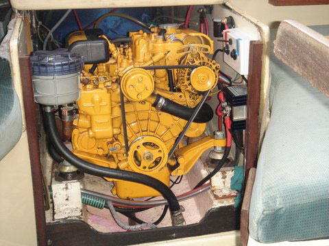

Nowt wrong in principle with diesels in small boats, but they need to be good ones (most are). Having had both outboards and inboard diesels I prefer the latter, but I'm a cruiser and cover long distances. If you just want to potter round the bay you're better off with an outboard.
An outboard has the advantage of lower weight for towing, especially if you can put the outboard in the towing vehicle, rather than leave it on the towed boat. If you can't, the outboard's weight is right at the back of the boat, just where you don't want it.
Diesel gives much better range, economy and waterside fuel availability. They are generally more reliable, last many decades, are easy to service, and can generate all the electricity you want.
But
a knackered and unreliable old diesel is a liability, especially in a small boat, where the cost of replacing it with something you can be sure will be reliable will be disproportionate. I suggest you get an engineer to check over; fire up; and give you an informal, verbal assessment of any diesel engine in a boat you are thinking of buying. (Formal written engine surveys are so hedged with qualifications they have little advantage, it seemed to me.)
That's what I did with the last boat I bought, the diesel engine of which is 40 years old (a Bukh), hadn't been run for 18 months but started within a second, and in the subsequent two years has proved very capable and reliable. I took a chance on a previous boat that had a recent replacement Beta, and that, too, proved very satisfactory.
Some older diesel engines are generally considered worth avoiding - Petter, BMW, Renault, for example (though some get good service from them). I believe parts are problematic for some older Volvos and Yanmars. A modern Volvo, Yanmar, Beta or Nanni should be no problem at all. Bukh DV series engines are simple and solid (though very heavy), and have been in continuous production for 40 years, and parts still all readily available. They're used in lifeboats, so low hours used ones from that source are fairly readily available as cheap(ish) replacements should an old one fail.

A few Anderson 22's ( lift keel ) have inboards of various types but these engines mean a lot of weight in the wrong place - aft, drag, corrosion, expensive to maintain and sacrificing very useful stowage space under the cockpit.

I have owned two Sadler 25s in my time. One had a 5HP outboard - the other an 11HP inboard diesel.
The one with the outboard was a sailing boat! The outboard, on a bracket on the port side of the transom, was unreliable in any amount of wind/sea. In a sea, even with a longshaft, the prop would come out the water then plunge back in. With any amount of wind on the port side, the prop would come out of the water - so I learned to motor on "starboard tack"!
Occasionally, on a relatively calm/level sea, 5HP wasn't sufficient to make any headway into a stiff breeze.
The storage under the cockpit floor was immense! When racing, we put the dinghy & outboard in there, and still had room for a large coolbox!
We only had one battery and no fueltank - but probably carried as much fuel in cans as we would with an inboard diesel.
The outboard had a charging coil, but since we didn't use the outboard much keeping the battery charged (for the VHF only in those days) was an issue. Log & echo sounder were battery operated. It was in the days before solar panels.
The inboard diesel was much much more dependable as a means of propelling the boat! Also charging the batteries. The downside was "the locker under the cockpit" was full of engine!!!!!!
