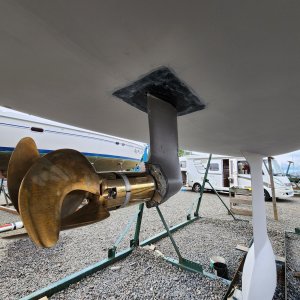

Just lifted my 25ft'r and she sat for most of the time unused ... which is usually death to props and AF ... but Wey Hey ... look at this ... and I have not pressure washed or doner anything at all ... this is straight from water :
View attachment 202397View attachment 202397View attachment 202397
View attachment 202395View attachment 202395
The AF is not available over counter before you ask ... no good PM'g me either ...
My point in showing is to illustrate how the rules on AF have made what you get over the counter = 'rubbish' .....
Jotun Seaforce 60/ Hempel Olympic or something similar? That's what I use when I can get itGonna make some of you envious now ....

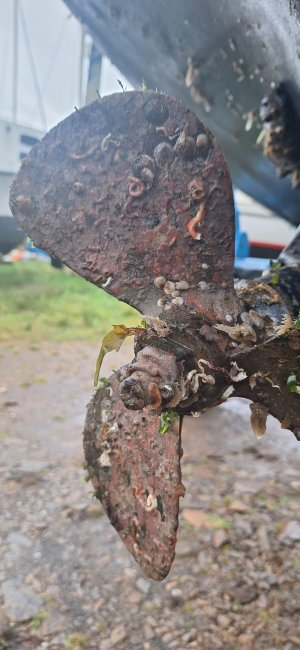

Loads of boats have come into Y Felinheli for the winter. Most won't need to clean off next spring as the fresher mountain water cleans the sea water residents away. Can't say the same for quite a few less active residents that have a dose of tube worm on their keels and props.Fresh water? On the Menai Strait we knew that a few days in Port Dinorwic, fed by a mountain stream, would almost totally eradicate fouling. When we kept our boat on the fresh-water Haringvliet we rarely had any fouling at all, despite sailing on the sea most weekends.

When we bought our boat 2 years ago the prop had been painted with a fouling release product 2 years previously, this is what it looked like:Has anybody tried Pellerclean Seajet Pellerclean ?
