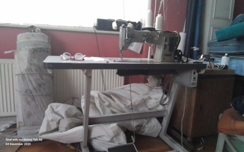

10 years ago I decided i was fed up of waiting and paying others to do repairs. Wanted an industrial with zigzag so i could also do sails.
I rang around sewing machines shops and mobile servicing/repair guys. It was fairly succesfull as quite a few knew of machines for sale.
Ended up with a pfaff 138 in a new table for £175 which i also later learnt is a highly desirable machine.
I struggled with the 500w clutch motor as it was nothing, nothing, light speed... played around with the clutch but no improvement.
I changed to a 550w brushless/digital motor. Absolutely brilliant and so small (£65) . Can dial in the max speed i want and have full control from around 1 stich per second upwards.
The only thing i struggle with is sails around 38ft+ boat in the corners. Broke many a needle and turning by hand shows just how much power is needed to get through.
Usually if the motor is mounted to the back of the machine its low power domestic but if its under the table and belt driven its industrial.
I can lift my machine out of the table, sit it in a wooden base like a domestic singer, fit a handle to it and use it as a portable manual machine.

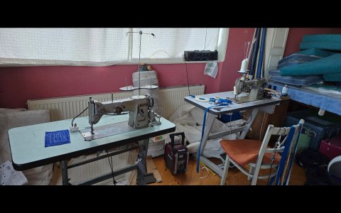

Where to look to find a good used one?
I dont know where your located but i may have found an absolute bargain for you or someone else.. a pfaff 238, zigzag and straight -£150.
Selling by solentsew.co.uk. Solent sewing machines make sail making machines and others... great company to deal with..
Machine in pic..

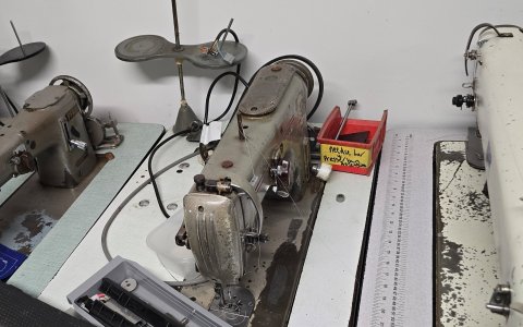

I went there for a presser foot, left with a whole machine :unsure: :eek:
