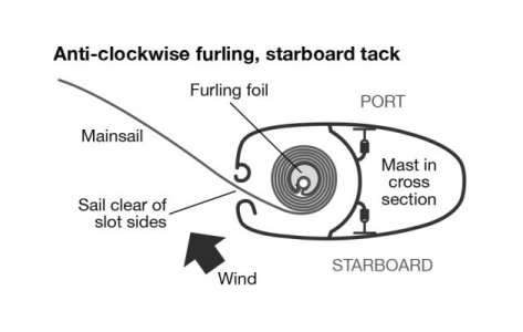

The sail is old. Wonder if it's a bit baggy?
Baggy sails with the stiffness gone are the kiss of death to an in-mast system .... they go in ok, but when unfurling they pick up loose folds from inside the mast and pull them out through the slot and if you don't immediately notice and stop, they jam hard in the slot and it's game over.
This can be mitigated if you unfurl with the sail partially filled and, if my memory serves me correct, on starboard tack. You want the exiting sail to be pushed hard against the port side of the mast slot, closing the gap completely and preventing any folds from being picked up and pulled out.
Old, worn sails don't end up neatly furled like in the above diagram, you end up with loose folds inside the mast.
Mainsail furling systems: an expert guide - Yachting Monthly
This. Baggy sails + in-mast furling = trouble. Save yourself a lot of agony and buy a laminate mainsail, which will never get baggy until the last day of its life. Also more flexible, lighter, and thinner -- all of which improve in-mast furling function (not to mention sailing performance).

Baggywrinkle #5 is right - everything is easier on starboard tack, with a little topping lift tension. Mine furls ok but can trap folds when unfurling if not on starboard. My sail is 35 years old but not over baggy. Mine is a Selden but no winch, only and endless line (which I can winch).

By no means an expert on in mast furling but I think it's not always starboard tack, it depends on the direction of furling ie is it clockwise or anti clockwise.
