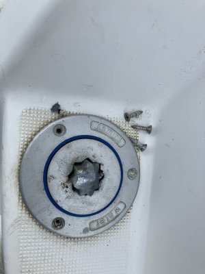

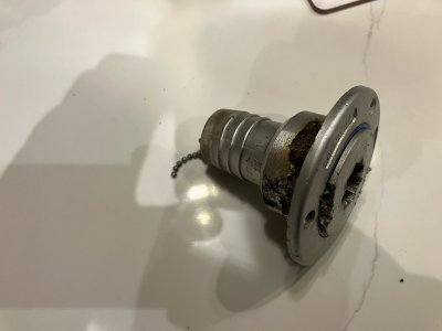

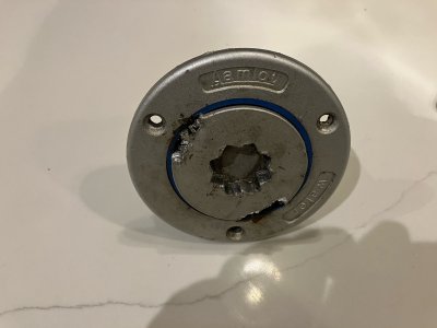

I have a seized deck fitting for fresh water filling. It is made by Amiot and consists an alloy threaded cap into an alloy base. It is off the boat now, it did rotate with great difficulty about 180m degrees then stopped solid, so we suspect something was picked up in the threads. The other 2 on the boat are fine, but do get more use). I suspect that the best course of action is to fine a suitable replacement. But happy to receive and suggestions as to how to remove the cap, but only worthwhile if a replacement alloy threaded cap is available. The fitting has been in the vice at home and a lot of heat applied by heat gun and attempts with punch and hammer made to rotate both clockwise and anticlockwise to no avail.

As above, soak - but if it doesn’t come out easily perhaps consider a bit for an impact wrench that fits the female winch handle type fitting on the cap. I had a seized fuel filler (aluminium that had corroded when the boat was laid up for a long time under its previous owner) and that was the only way I got it open. Subsequent regular greasing has kept it easy to open since.

You could first try boiling it in water for half an hour or so then quickly mounting it in a vice and using a winch handle to try to turn it. The winch handle will fit in the star shaped hole and will give you good leverage and won't further damage the item.
After that it's soaking in acetone/ brake fluid mix for a week and using the winch handle.

Scrap it. There's now so much damage to the outside of the plug it's unlikely to seal properly. The star socket is also damaged, the tool will be a very bad fit causing more grief. It might not have been scrap before you started on it, but it is now. A learning experience.
Yes, it is getting scrapped, even if it seals, it is now ugly. After soaking in WD40 overnight, still no movement with a big hammer and punch, I suspect something (dirt) has picked up in the threads. It will be float tested (not in the tank).
