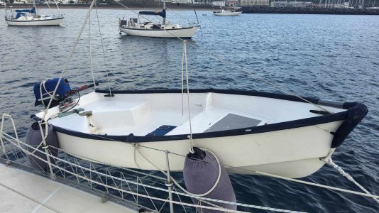

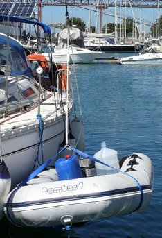

I have seen tenders suspended alongside - how does that work.
When I need to haul it alongside I use a halyard, the dinghy is lifted by the same two points I use with the stern gantry; if you lift it both with and without outboard the two legs of the bridle should be of variable length otherwise it won't remain horizontal (at least mine doesn't).
Here I was taking measurements with/without weights aft.
