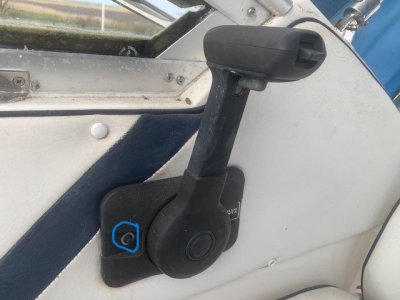

Does anyone know what this little switch is for on my sealine S24 Throttle the one circled in Blue in the pic below
Looks like the switch you press and hold to allow the outdrive leg to be raised above the beach position ? Otherwise the leg will not trim up above +6.
As Momac has said, it overrides the outdrive trim to go above +6 to +40, essentially beach mode. In the +40, don't engage drive above 1000 rpm i.e. tick over, also steering will be minimal. Press and hold the button and you will hear a click, sometimes the button can be temperamental.

But on the basis that this is the control without the trim/tilt switches, it's reasonable to deduce that the switch is the tilt limit override.
I have received good advice that it seems that it is indeed the button you press to allow the outdrive to go up very high for what is Beaching mode or in my case Trailering mode.
