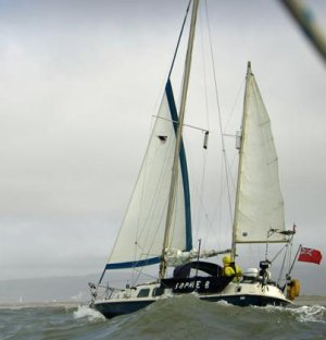

A pentland for rough weather and here is our old pentland in turbulent water off Ilfracombe in a fading F6 with big rollers (taken by Coral B who followed us out to Lundy as storm faded. I love the comfort of our present LM27 but she is not as sea worthy as the pentland. Badly drained cockpit and non-locking cockpit engine hatches plus big voids from cockpit to bilge. I never feared being pooped in pentland but look at breaking following seas with concern on LM. Of course if you can afford an LM30 or LM32 Scanyacht 290 they had sorted all that and doesnt roll as much.
I was tempted by Seadog 30 and would have completed encolosure of cockpit but Navigator thought LM27 prettier inside and out which it is

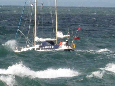

And I miss our ketch rig. Saw a single hander win race against faster fully crewed boats by not reefing but dumping as it gusted F7 off Brightlingsea. By the time the others had reefed he was 1/4 mile ahead.
Damn nearly as fast under genny and mizzen alone, and no nasty deckwork if it worsens just the genny furling lines. Heres us in F7 with wave protection from sandbanks
Great pictures. It's hard to explain to non ketch sailors the comfort of a reduced jib and mizzen on a decent displacement hull.
