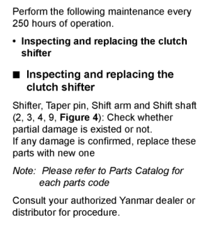

If the tapered pin for the dog clutch is worn what are the symptoms?
Would the shift from forward to reverse cause a grinding sound?
If wear in these components results in the clutch not engaging cleanly then the clutch will be damaged and eventually likely to jump out of gear under high loading.
If the grinding sound you hear is the clutch failing to engage cleanly then inspect the above coponents before any damage is done to the clutch.
Correct adjustment of the control cable is also relevant.

Does the assembly pull out together?
So there isn’t a chance of parts falling in the lower case?
Yes
Google will find you the complete parts diagram / list if you need it.

Yes the unit comes out or yes parts canfall below??
Yes the unit comes out as a complete assembly
Parts should not fall, but sensible to withdraw carefully in case something is wrong/broken.

Inspection of the shifter is one of the items on the routine maintenance schedule for Yanmar sail drives. Detailed in the operators manual.
AFAIK VP do not publish separate owners manuals for their saildrives. The recommended routine maintenance is described in the engine manuals
