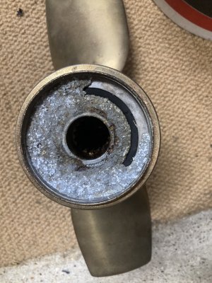

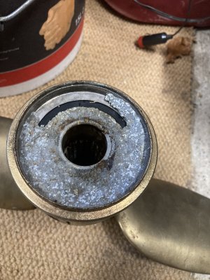

The VP sail drive prop at the front (the end facing the leg anode) has an aluminium disc insert, very much like an anode. On my one it has almost been eaten away.
Does anybody know of a company that,
1 sells them
Or
2 repairs them

Ah, sorry should have mentioned that it’s a two blade folder. Will try attach picture

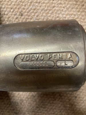

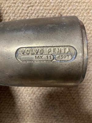

OK Then most have anodes, If it is a Volvo badged one there are segment anodes on the hub. You need to identify the make of propeller. Volvo anodes are widely available but some other lesser known makes may only be available from the manufacturer or their distributor.
