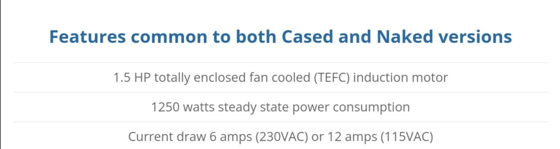

Hi all, as our schenker modular 60 watermaker is awaiting some spare parts for me to strip it down and hopefully repair it, have been looking at redundancy options. One of these is there is a used 110v ac rainman portable watermaker near us for sale at the moment BUT it is 110v ac (we are 220v ac). Plan could be to purchase it as a spare and then either keep it or sell it on before we leave the Caribbean for the UK.
So, could this unit be run from our 3.5kw 220v generator via a step down transformer if required? Here are the specs:

The specs mention both 230VAC and 115VAC current ratings. Is that for two different models? Are you certain that it isn't capable of running off 220v directly?
HissyFit
13 Jul 2020
682
2 different models unfortunately
I was just going to strike through my reply, having seen the Sail Life YouTube on this.
If the current rating on your step-down transformer's secondary is sufficient, you should be OK to go that route.
