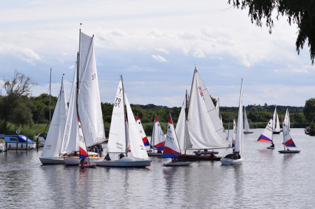

Said mark
217 is likely to be coming straight on, the camera is at the finishing line, the rest are trying to round the mark seen under 70's bow, the boat on the left of the picture has got it wrong and will have to do a quick 360 to turn round behind 217.
