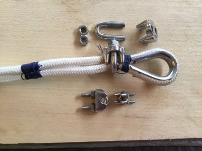

Take a metal tube (experiment for size) hammer to an oval shape (or distort in a decent engineers vice) file ends to present a smooth surface. Drill, tap and insert short, say 4mm dia, Alan keyed bolts. Insert overlapping torque cord (as in my picture above) apply Loctite, blue should suffice, insert and tighten bolts.
edit
You could use a series of copper ?, oval swages (the sort you would use on old fashioned wire halyards) maybe over shrink covers suitably drilled and tapped with LFRs for the eye. If you don't like the idea of the bolts damaging the rope then have 2 swages, one inside the other but don't drill the inside one simply tighten the bolts to compress the inner sleeve onto the internal overlapping rope.

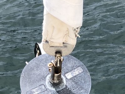

For completeness this is the alternative for an unstayed headsail, call it a Code Zero or Screecher. I'd forgotten I had the picture. This is of no use to the OP as he already has the torque rope for his stay/luff.
This semi-circular device is custom made, I don't think too difficult to make oneself. Its basically half a sheave with a slot to accept the tape. There is another identical device at the head of the sail. The half sheave, or 2 half sheaves retain a continuous loop of dyneema separated as shown and sewn to act as the luff of the headsail. There is an identical swivel at the head, these are Ronstan swivels.
In use the halyard is bar tight which keeps the double dyneema luff loop separated and when the sail is furled the loop acts just like a standard foil and the sail furls round the loop.

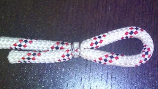

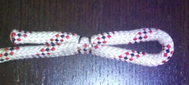

I reckon an eye made by using 2-3... successive clamps of this type with 1 or 1.2mm stainless steel wire wound very tightly might be worth testing with a winch, a car, whatever you have to create a high load.
Just tried with a piece of line I had at home, 2x8mm rope total 1sqcm can be easily compressed to about 0.7sqcm, I reckon more with thicker wire.
No idea of the load it could bear but it looks neat :)

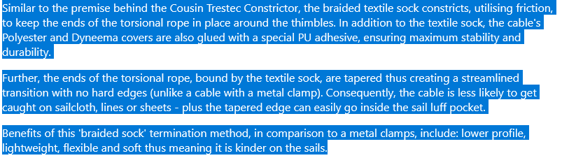

This is what was actually posted about splicing the torsion rope by Kohlhoff. I'm not sayin' I understand it, but it is not just glue. I might guess that the adhesive is something like the Amsteel coating (a polyurethane adhesive). I've never experimented with using hollow braid to secure an eye splice, but it sounds interesting. It works in a clutch and in single braid splices. But my guess is that there are simpler ways to splice most ropes and this only makes sense for certain unsplicable, unsewable ropes.
