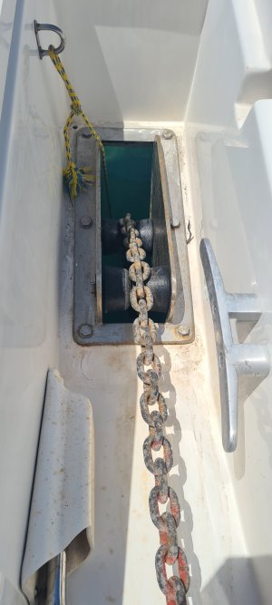

The bridle is attached to the chain with a snap shackle which has to be manually attached/detached each time. This is not a big issue in itself as leaving the helm to do this is not an issue as the anchor is already set. On my previous 34' powercat I could easily see the anchor roller from the flybridge helm and was able to see the angle of the chain and adjust accordingly.

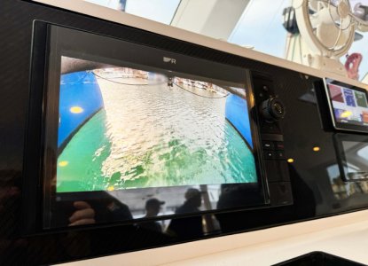

'the forward camera doesn't help - it sees the windlass but not the anchor roller'
move the camera so it shows the roller and direction of the chain ?
Correct. It helps when I have another person at the windlass. I can see generally what they are doing and interpret hand gestures if necessary. There's not enough adjustment on the camera to see to anchor roller. Even if there was, I don't think I'd see enough to determine the direction of the chain. This is a close up view of the anchor roller taken just now with my phone and less than a metre from the roller. The fixed camera is overhead and I don't think it would see even this much

I think your best option is a camera to specifically look at the anchor and chain. Most of the Balance catamarans (if my memory is correct) have such a camera installed. You could take a look at what hardware they have used and where the equipment is mounted. Presumably the manufacturer has sorted out the bugs by now.

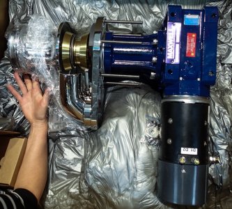

A larger windlass has been suggested. This would also work for most conditions, but it would need to be a large unit to have enough power to consistently pull the boat forward without using the engines, something that is not normally recommended. I don’t think it would be practical to fit such a model. We fitted a 4000 lb commercial windlass to our current boat. I was surprised how much bigger and beefier it was compared to the only slightly lower capacity 3500 lb recreational unit we had on our old boat.
A large anchor windlass is also a great asset if you are anchoring frequently. It has made life much easier on several occasions when our anchor chain has become tangled with debris. So there are other benefits to this change, but you need a large amount of room to fit this type of windlass. With your extra windage I think you would need at least a similar size windlass to our model for long term reliability (if you want to pull the boat forward without using the engines). The camera is going to be an easier solution.

Perhaps an iPad connected to a GoPro would tell you if the concept works?
I actually played around with a GoPro and 10'' tablet today from different positions focusing on the anchor roller, but it was of little value, possibly because the target area is small and dark compared to the positions of the camera. I didn't have the means to secure the GoPro under the bow but I'll have a go at it in the next few days when I have help on board. My GoPro is a bit old - Hero 5 - so maybe a newer model might give better resolution.

1) the hawse is badly located, so the rode does hold the boat pointing the right way way without a bridle actually fully working.
2) you don't have fine enough control of the engines to keep the rode lightly tensioned or slack.
Arguably thirdly, you don't know the relative positions of anchor and boat accurately enough.
And fourthly, the hawse design is not tolerant of the rode being anywhere other than directly forward of the hawse.

I don't think a cctv view of the problem is actually much of a solution.
