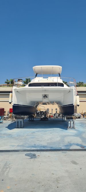

20240725_154816.jpgI love my boat which I bought 3 months ago but retrieving the anchor is an absolute pain and near enough impossible when single handed. Anchoring with a catamaran is always a bit more problematic but this is a bitch. The anchor roller is located approximately 3 metres back from the bow and is impossible to see from the throttle position on the flybridge. Once the bridle is off the boat swings very fast especially with any wind or waves (a given in the Aegean in summer) and you quickly find the chain is at right angles to the roller.
I've been discussing with my more technically minded son the possibility of fitting an IR camera under the bow and connecting it to my Raymarine network. He's looking into it to see what's involved.
PS - the bow roller you see in the pic is for manually deploying and retrieving the auxiliary anchor.
You definitely need to be able to see what’s going on. Perhaps one of those “door bell” camera systems would work. Keep it simple. There’s no real value in linking it into your Raymarine network, as it will only get used when you’re weighing the anchor.
Nice boat, by the way. I presume you prefer it to your previous cat or you wouldn’t have changed.

If you want to know where your anchor is and you can't judge it by the direction the cable lies because you can't see it, how about buoying the anchor?
Thanks. I've thought about it, and while it would certainly help to identify the location/direction of the anchor it adds another complication in terms of recovering the buoy. I accidentally dropped the bridle some time back and it was an absolute bugger to retrieve it through the very limited opening of the anchor roller - I've added a recovery cord to the bridle since then. I may play around with an anchor buoy when I'm a bit further from shore but definitely wouldn't want to be messing with it in the circumstances I described above where I'm relatively close to shore with significant onshore wind and waves.
Is there any advice from the manufacturer? I don't suppose there's an Owners website or anything.
Does look rather difficult....
Thanks. I think the reality is these boats were not designed or intended for single handing. Leopard produces motor cats primarily for the charter market and I imagine there aren't too many singles looking to charter a 43' catamaran. I think an under bow camera will be the best solution.
