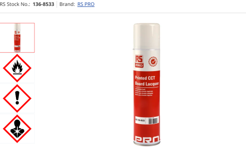

Conformal coating is the product specifically produced for this application. It's easily available, not expensive & easy & quick to apply. It's pretty much guaranteed to be compatible with what you wish to apply it to & is widely used in industry for corrosion protection of circuit boards in applications that do not need to go to the length of potting. Using a product not intended for circuit board protection is a bodge.

100% agree on this, I worked for a company producing electronic test equipment to a very high standard, our top DMM was £17,000 . Conformal coating is definitely the way to go.

Fair point Angus, and looking at some of the other electronics-dedicated products linked, my suggestion also seems a bit out of date. When I read the description of pouring in something rubbery to fill the case, potting was what came to mind, but conformal coatings probably offer a more convenient way. Also it's not as though this needs extreme shock resistance.

As for conformal coating, yes great on a pcb post production but not what I envisaged the OP wanting for an led light.
