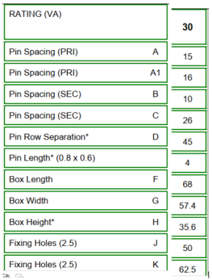

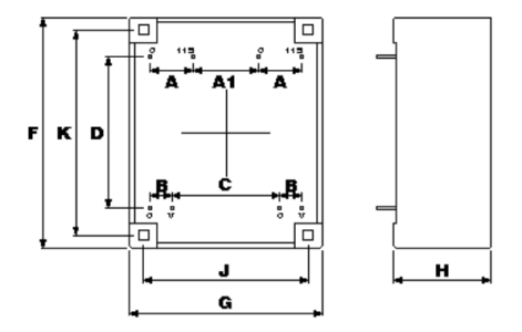

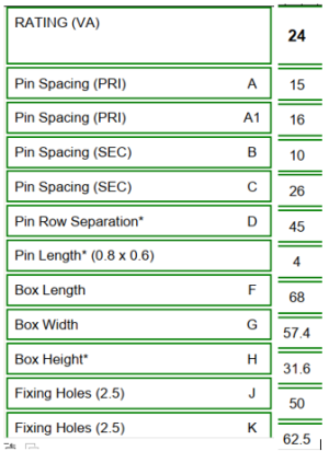

Clairtronic is (was) a well known transformer manufacturer but it seems that the company has been wound up.
Transformer details are here: Clairtronic PDF
There is an RS item that looks almost identical. https://uk.rs-online.com/web/p/pcb-transformers/1213858?gb=s
It is 30VA instead of 24VA and one of the pin spacings is 15mm instead of 16mm but you could probably bend the pins enough to fit, Full measurement details are on the RS datasheet.
You might find it is a standard size and there are other suppliers.
Clairtronic 5041 dimensions:
RS dimensions:

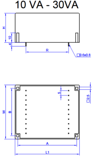

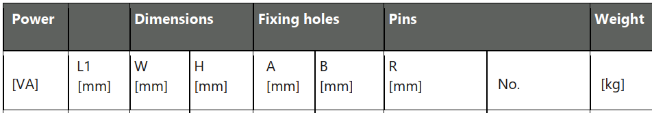

It looks like a standard size as I think these at 24VA and 30VA are available from CPC
https://cpc.farnell.com/block/fl30-9/transformer-30va-2x-9v/dp/TF01076
You will have to check the dimensions on the data sheet.
