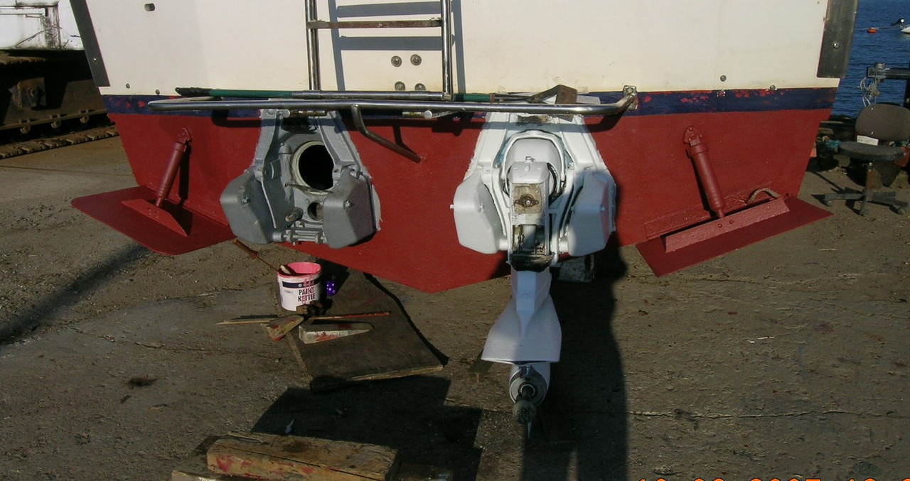

The port side leg is off
Good news is no sign of any water ingress within the UJ / bellows area
Quite a challenge but very rewarding to get the job progressed this far . I suspect putting it all back together will be fun.
Tomorrow shopping for a 7mm socket for the inner Jubilee clip on the UJ bellows which appears to have no slot for screwdriver use , plus some more WD40 or the like.
And a good clean up in the inner surfaces of the transom shield area is required now it is exposed by removal of the leg.

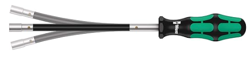

Bendy hose clip driver ordered

I can see this is going to be fun.
Progress has been slow due to factors like floods, weather , work and Christmas
Next time I will be retired so will arrange for the boat to be out in the warmer months where progress might be more swiftly and certainly more comfortably achieved.
