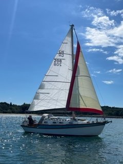

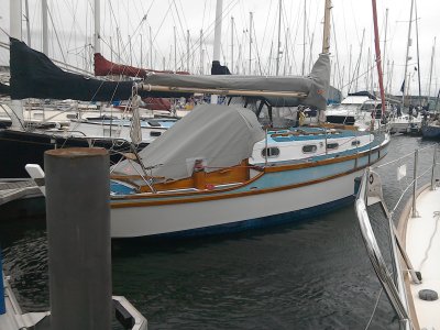

This all sounds very familiar. I am in the process of making sail handling easier on my Golden Hind with its (relatively) huge low aspect ratio mainsail and single line reefing from the cockpit. This is so that I can do it all single handed from the cockpit with confidence. The loads of string dangling is just one of the problems. This year has been one of giving it a try before making drastic changes and fitting the hardware to take the lines back. The one major change so far is to fit a Tides Marine sail track so that the main is easy to lower and raise. The stack pack and lazy jacks were made so that all the unused sail and string when reefed would be collected easily on the boom. Because the reefing lines run below the stack pack I have put a fairlead about halfway along the boom, but quickly found that is not enough and will now add 2 more to minimise the droop. So far I have not reefed for real, only when moored up and clear that I need low friction leads back to the cockpit. This winter's job (one of many!). Couple of photos to give an idea of the boat and rig.
I have never liked slab reefing - I added it to my earlier smaller version of this design over 30 years ago to replace the roller boom, but have always felt like it is making the best out of what is essentially a bad system. Not just the miles of string and friction involved but essentially limiting available sail area to only 3 pre-determined levels - and all the unused sail needing to be put away on the boom. Given that people make so much of the importance of the lower part of the sail it seem bizarre that when you need efficiency that all gets lost in a bundle of redundant sail. Hence my enthusiasm for in mast furling which I have had for the last 20 years. Infinitely variable sail area, easy reduction and surplus unused sail neatly stowed in the mast leaving the working bit to work efficiently The arguments about loss of sail area and shape really don't wash with boats designed for the rig and sails made specifically for the characteristics.
Anyway one is stuck with what one has, although when I add up all the cost of making this lot work I almost wish I had junked the mast and boom and started with a new Selden in mast. Now I console myself to treating it as a challenge in my old age!
