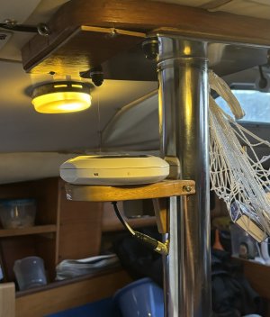

We had a problem when originally on cabin bulk head, moved it to mast compression post on a small wooden bracket, works very well and more stable control. Also out of the way from all stuff, as you said on a smallish location can be a challenge
