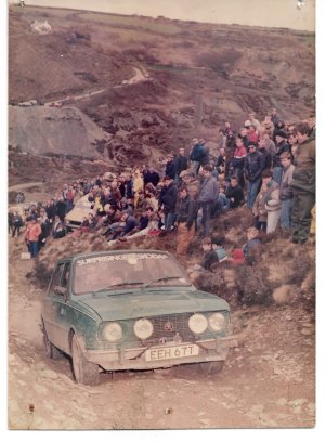

There was a bit earlier about using a pensioned off diving bottle.
When First Mate and I did a couple of MCC Classic Trials in a car - Lands End Trials in the early 90's - I used a pensioned off diving bottle fitted with a car tyre inflator to re-pressurise the rear tyres once tarmac was reached. The driving tyres were deflated for a better 'footprint'.
The bottle was 'loaded' with the workshop compressor to about 150psi. It lasted the whole trial, about twenty sections, so forty tyre top ups.
Not sure it would inflate a dinghy after being filled by a workshop 150psi compressor. Any higher it would, IMHO, need to be certified.
We went back to the Tri-BSA Sidecar soon after. The bikes were more fun.
Pic shows the 110 BHP Skoda Estelle on Bluehills Mine.
