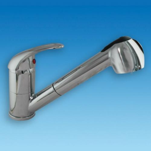

Mine is similar to this or this - when used as a normal sink the shower head is effectively just resting in a holder; the hose just disappears down a hole.
When you look in the cupboard underneath the connection of water to the shower hose is well obvious.
