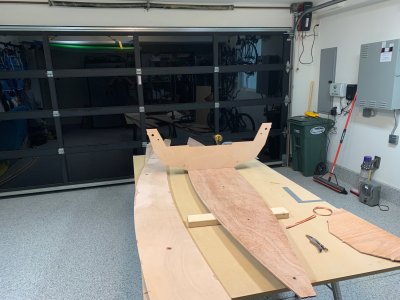

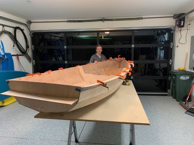

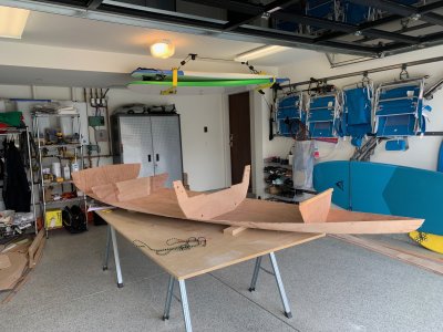

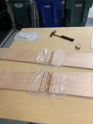

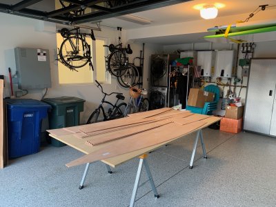

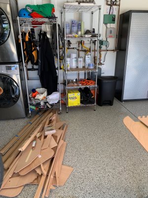

I am in US. Ordered the kit from Chesapeake Light Craft. I think they ship everywhere but not cheap. First step was to join panels end to end since the shipping package was only 7’ long and boat is 11’. Instructions are really clear and detailed. So far I am on p50 out of 300 pages. Great fun when you get to the assembly stage and it starts to look like a boat.

They call it a jigsaw joint. Even though the plywood is only 1/8” thick, the joint is a tight fit and feels as strong as the plywood once glued with epoxy. The layers of fiber glass mat and epoxy on each side should make it even stronger. So far have just put fiber glass on the inside of each panel. The outside layer is put on with the boat assembled.
