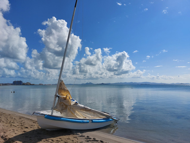

We chose a Spindrift 11N and we're very happy with it. Using an ex sailing club scrap dinghy as a donor (rig, rudder, hatches, etc) total cost was about £800 including Robbins Elite ply, and I still have about a third of my epoxy left over.
It motors about 6kt with a small 2 stroke, I can row it at 4kt, and it sails about 4.5kt in gentle conditions. I've had it out in stronger conditions once which was... sporty.
It's already used up two of its nine lives- once when we were rear-ended by a motorboat, causing extensive damage to the dinghy which was in the davits, and once when it went walkabout in the night but was located not far away bumping against the rocks. Being ply epoxy it's not too hard to fix even major damage.
One thing about these dinghies which I think gets overlooked is the importance of adequate fendering. If you want it to be a genuinely practical tender, it needs good fendering. We went with split PVC hose over the gunwales, plus a 4" pool noodle just under that. The pool noodles are sacrificial but provide very good fendering and a little reserve buoyancy.
