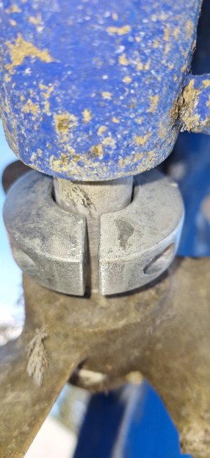

Hi
Does it matter that the prop shaft anode I'm about to fit doesn't clamp completely round the shaft? There is a gap as you can see from the photo
It's a 1inch shaft and a 1 inch anode.
It's just I'm sure the last anode fitted right round the shaft with no gap.
Thanks

A small gap wont matter.
It's better that there is small gap than the two halves coming together before they are really tight on the shaft.
Are you familiar with the "2 hammer" technique of ensuring that the two halves are really tight against the shaft?

Great thanks. And yeah I know about the 2 hammer thing actually. Last anode I fitted fell off pretty quickly and it's only when I research it I found out about that trick.
