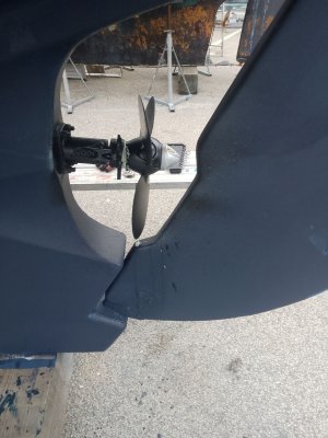

My Featherstream prop anode lasted less than a year so I have now painted the whole prop with Ecopower and added a hull anode. Only done last October so no feedback yet. However the logic is sound and will be disappointed if it doe not work, although doing 2 things at once may make it difficult to determine what works.
