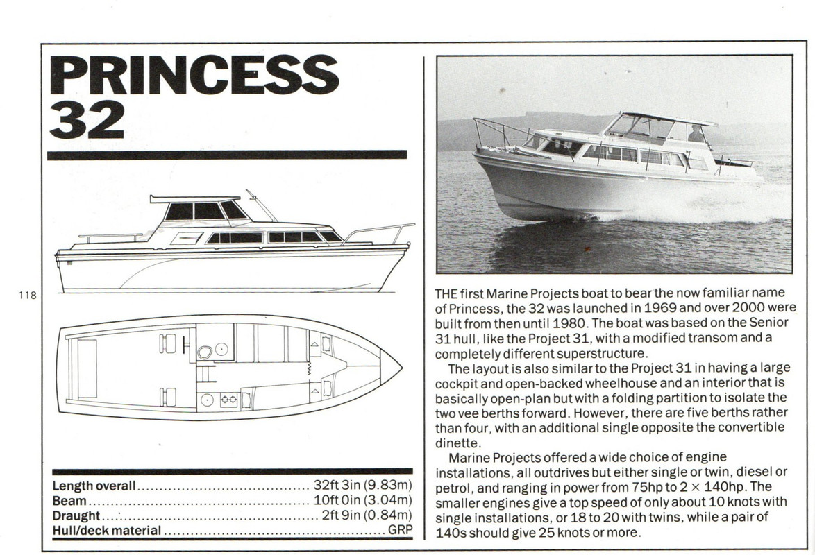

Different people want different things, me, I want a turnkey boat where I can spend my introduction to boating learning how to go places....other people enjoy a project. This boat is a project, either to do yourself or project manage others.
No, it's a Princess 32..the project 31 was the same hull different top.
However as said above all good advice, it's a risk and its likely the seller will sell at a lower price, but it will still cost above market value including repair costs. There will be other boats about that will wish you had considered. Take your time.
I believe Bouba meant it's a project, Not a Project 31. I'm a great believer in projects, all my boats have been projects. But I could do all the work myself and save money along the way. If you can't do it yourself as the OP admits then it will be a money pit.

The boat could be up to 50 years old along with everything on it .
Replacing that transom is serious and big job...Thousands .....if you can find somebody to do it, must be approaching the total value of the boat.

Can you get spares for the diesel engines
Possibly petrol engines. But a good point about spares.
