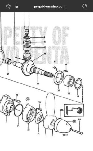

Surely a castellated nut and split pin are foolproof.
Sadly, these Volvo saildrives only have a thin plastic washer, a cone that is tightened first and then a long cap had screw down the middle that's locked against the cone.
I had always thought it strange with neither a castellated nut with pin, nor a tab washer to hold this into place.
I must admit, using a split anode now, I no longer have to remove and refit the prop on every anode change nowadays.
Looking at an online schematic though, I found one that appears to show a Volvo saildrive leg with washer/cone/bolt but in a small box above that, there is what looks like a castellated nut and securing pin.
Is that possible? To replace a cone and bolt with a castellated nut?
